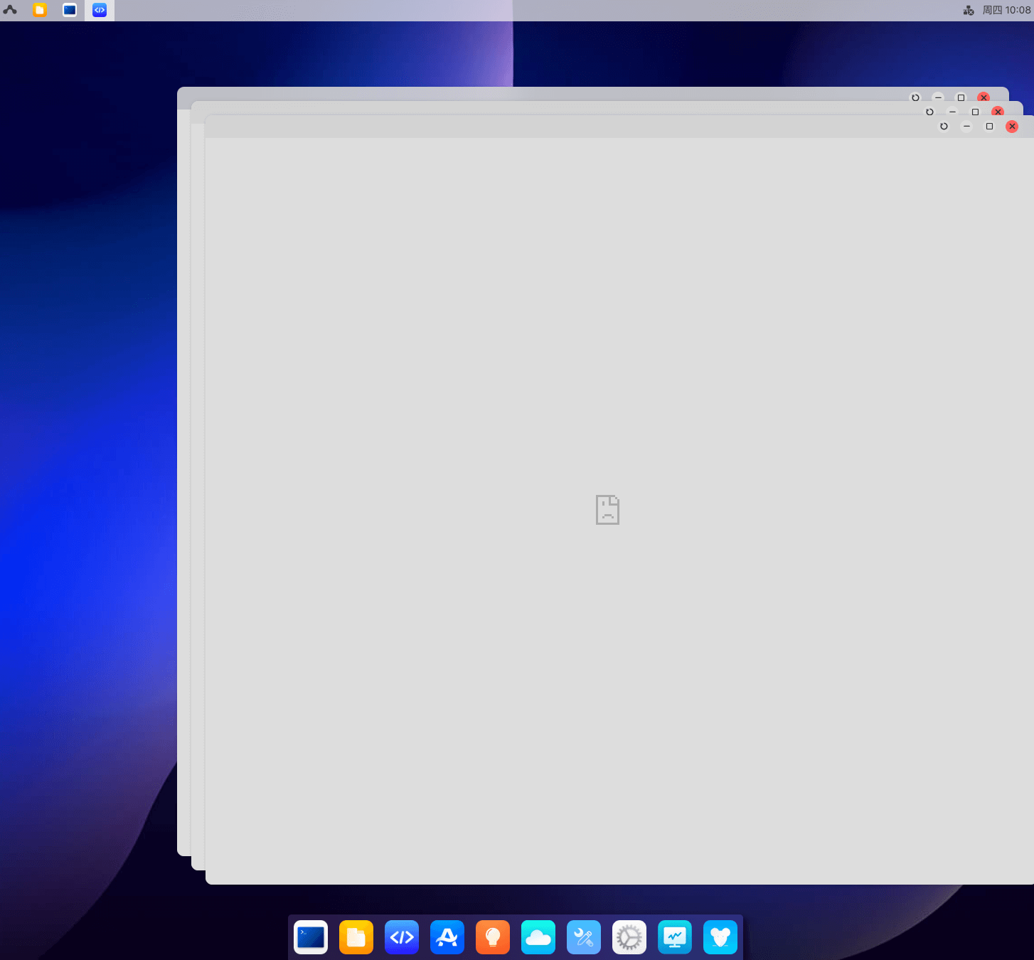

AidLux web remote port 8000 can be accessed, but terminal, filebrowser, aidcode cannot be accessed. What's the problem?
Some applications cannot be accessed
This problem is usually caused by the system service nginx failing to start. We can first check whether the nginx status is normal.
Since the remote desktop terminal cannot be accessed, we need to directly log in to AidLux Linux. The connection method can refer to linux login, aidlux login.

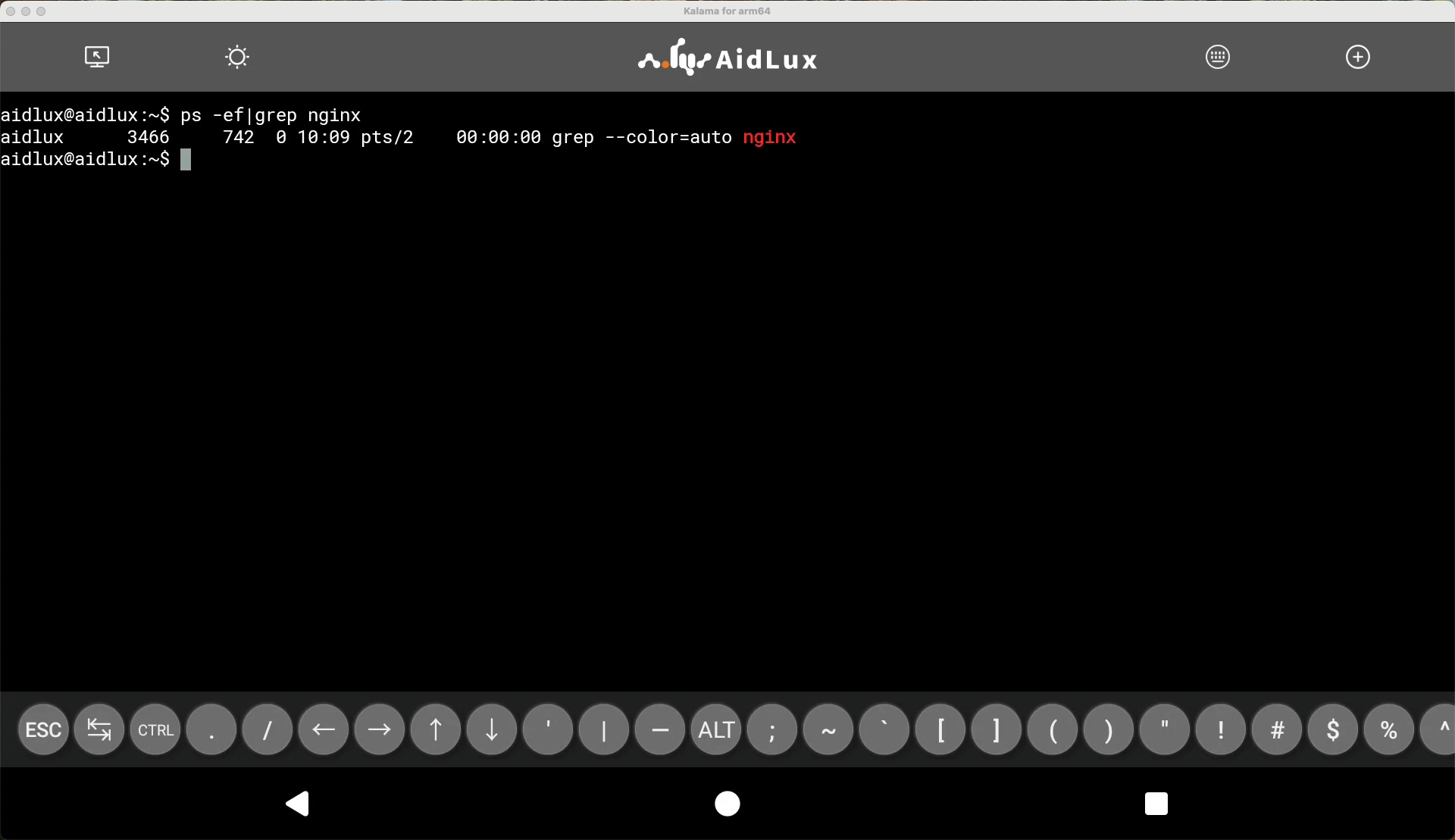

Execute the following command to check nginx status:
ps -ef|grep nginx
nginx service abnormality will show the following situation:
check nginx process

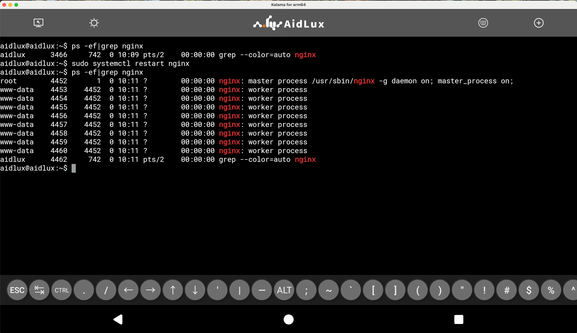

We can try to manually start nginx:
# enterprise 企业版
sudo systemctl restart nginx
# 所有版本适用 (密码默认为: aidlux)
sudo nginx
After nginx starts, checking the nginx process should show as follows:
Start and check nginx

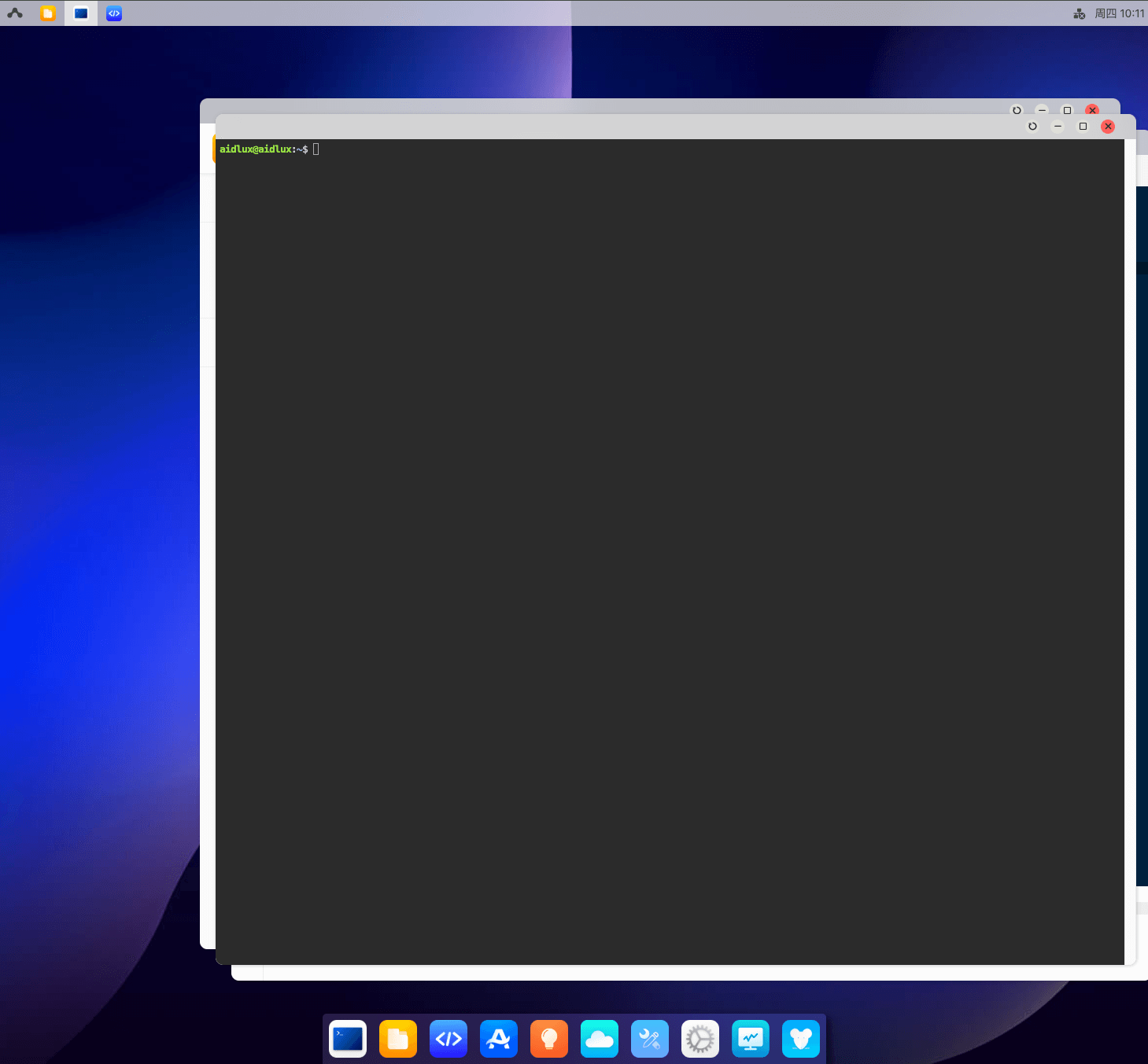

Under normal circumstances, now remote web access to terminal, filebrowser, aidcode should be able to access normally, the result is as follows:
Normal access
