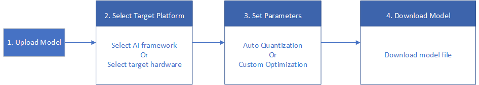

The AIMO workflow is shown in the diagram below:

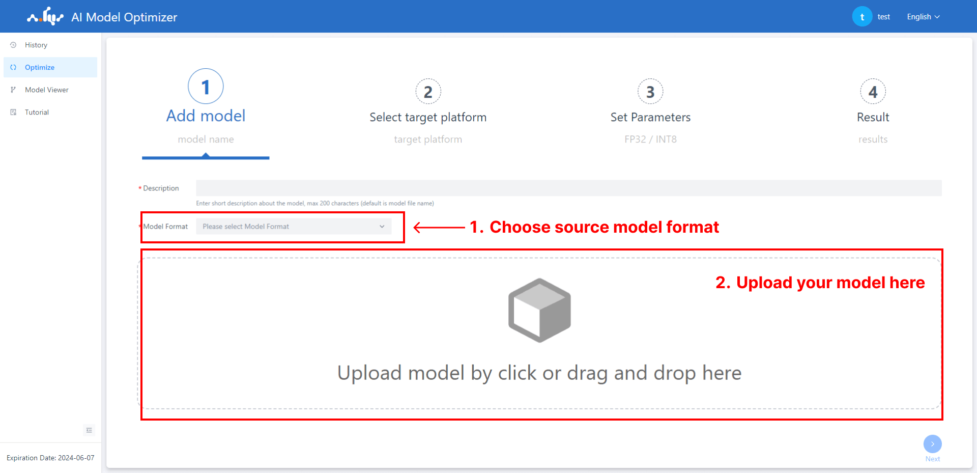

Step 1: Upload Model ​
First, select the source model format, then drag and drop or click to upload the model to AIMO.

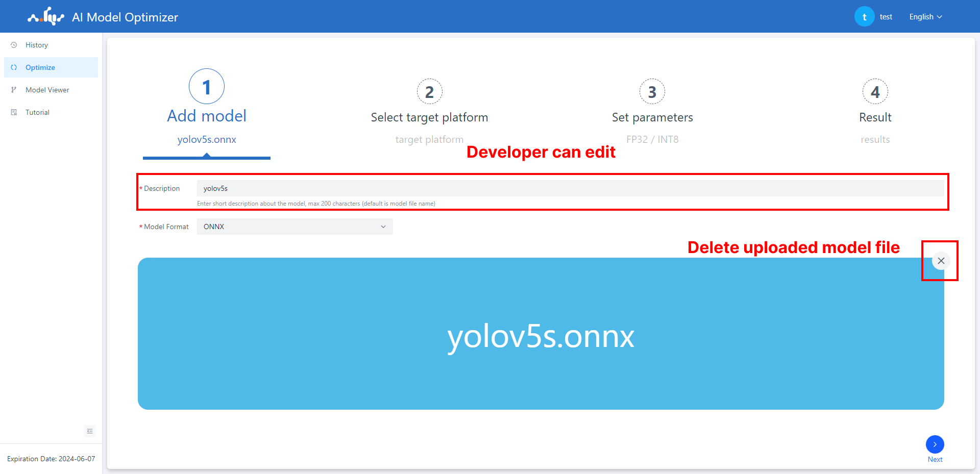

After a successful upload, the page will appear as shown below. The Description field will be auto-filled based on the model filename, and developers can manually edit it.

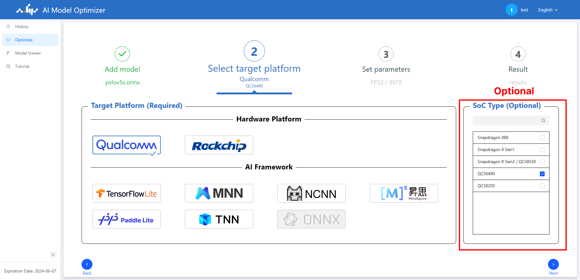

Step 2: Select Target Platform ​
In this step, select the target platform. When the developer selects an option from the Hardware Platform, the Chip Model section on the right will display the supported models, as shown below:
💡Note
The Chip Model is optional. If a specific hardware model is provided, AIMO can perform better hardware-specific optimization.

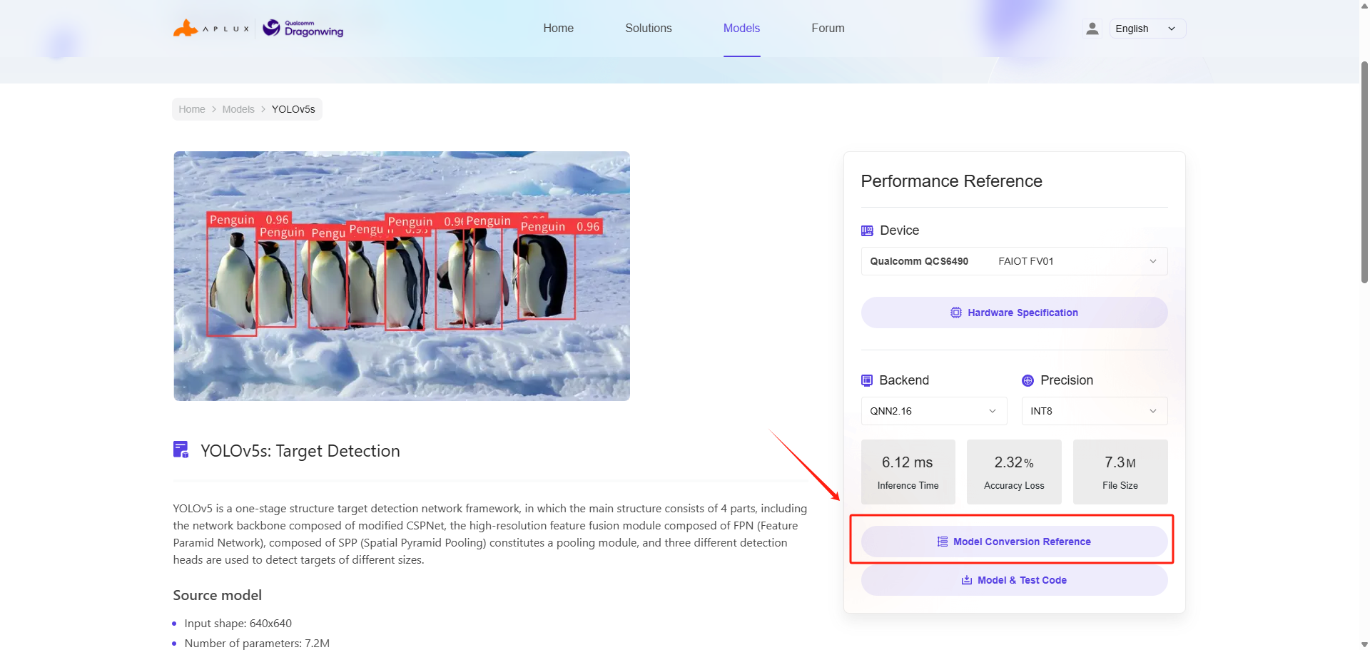

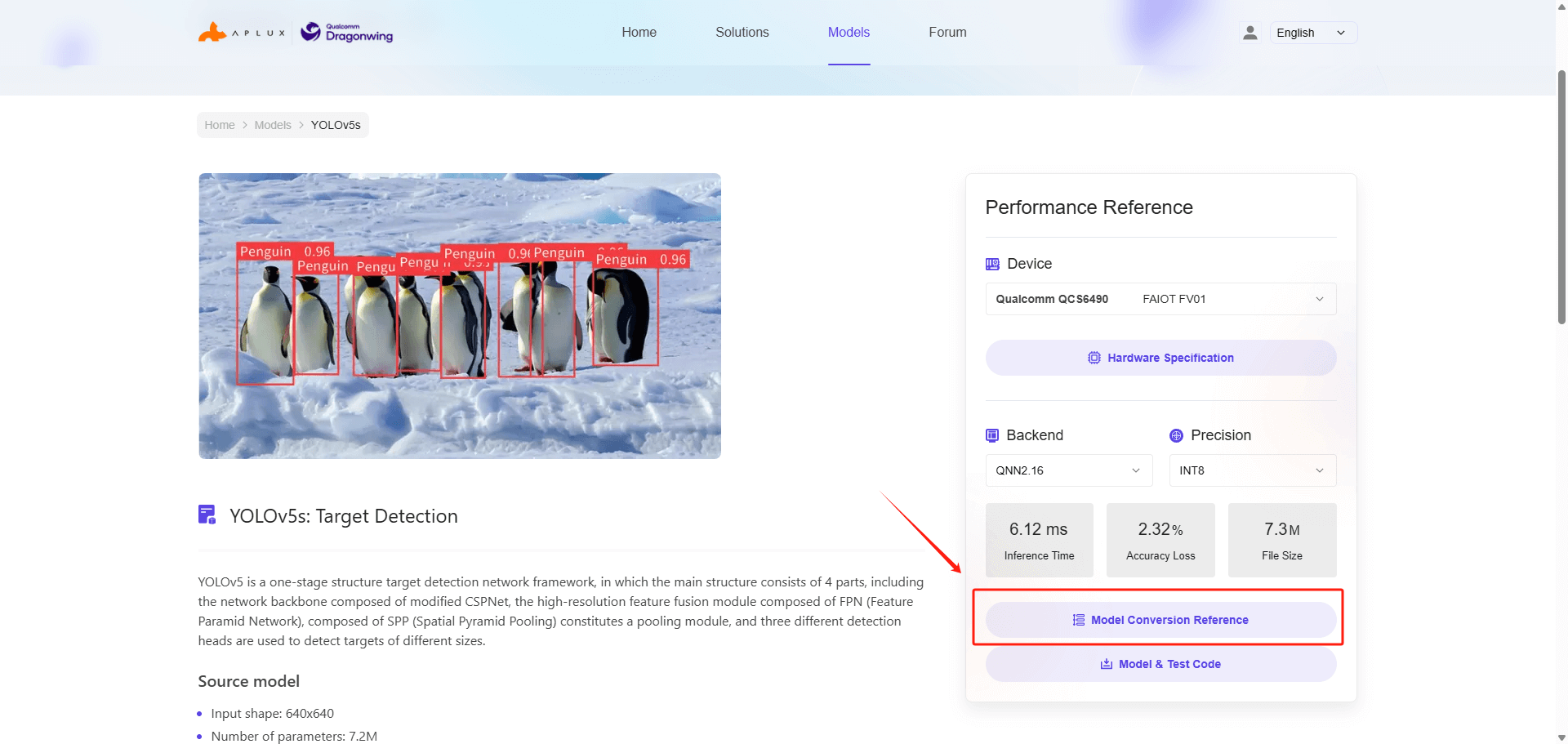

Model Farm provides a large collection of models converted via AIMO for Qualcomm platforms. Developers can view the AIMO conversion steps in the model details page for reference.
Taking YOLOv5s INT8 as an example:
  • Visit Model Farm
  • Log in developer account
  • Search for YOLOv5s
  • Enter the model detail page and click the Model Conversion Reference button under the performance section on the right
