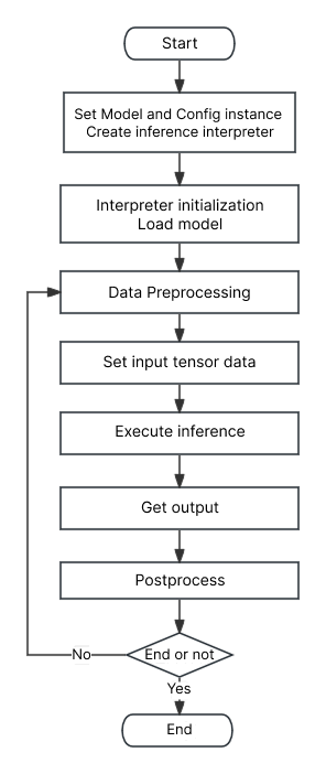

Development Flowchart ​
Development Workflow Explanation ​
💡Note
The following code demonstrates the core development flow. For full API details, refer to the AidLite API Documentation.
The following points should be noted when developing with AidLite SDK in C++:
  • During compilation, you need to include the header file located at /usr/local/include/aidlux/aidlite/aidlite.hpp.
  • During linking, you need to specify the library file located at /usr/local/lib/libaidlite.so.
