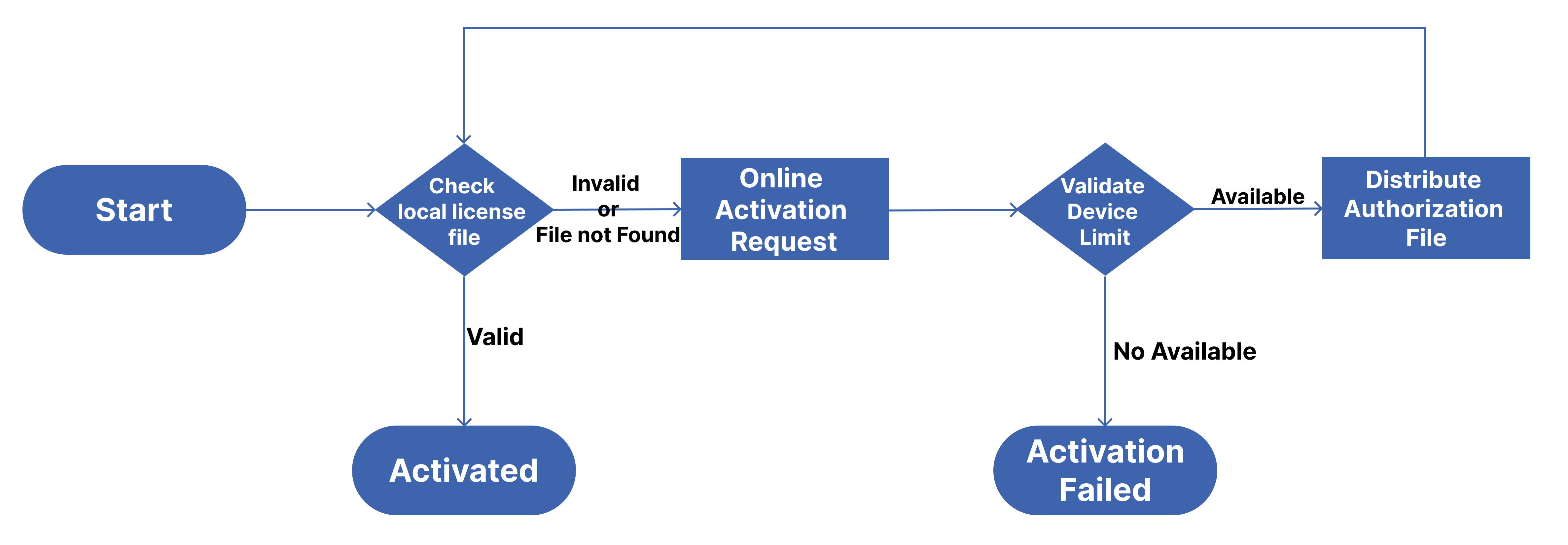

The development kits provided by APLUX must be used in an activated environment. Activation is performed through the LMS component included in the AidLux SDK.
LMS activation uses an online-first authorization approach, followed by offline license validation. The workflow is shown below:

Activation status for different types of development boards:
  • APLUX AidLux OS Dev Board: LMS is pre-activated in the Linux system environment.
  • APLUX Linux Container Dev Board: LMS is pre-activated in the container image.
  • Third-party Dev Boards: Please contact APLUX for activation and licensing guidance.
💡Note
If a previously activated board is reflashed with a new firmware (ROM), it is treated as a new device and must be reactivated.
