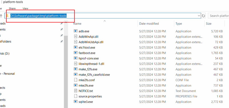

2.1.2.1 Unzip platform-tool.zip ​
  • Unzip the platform-tools.zip file to the D drive.

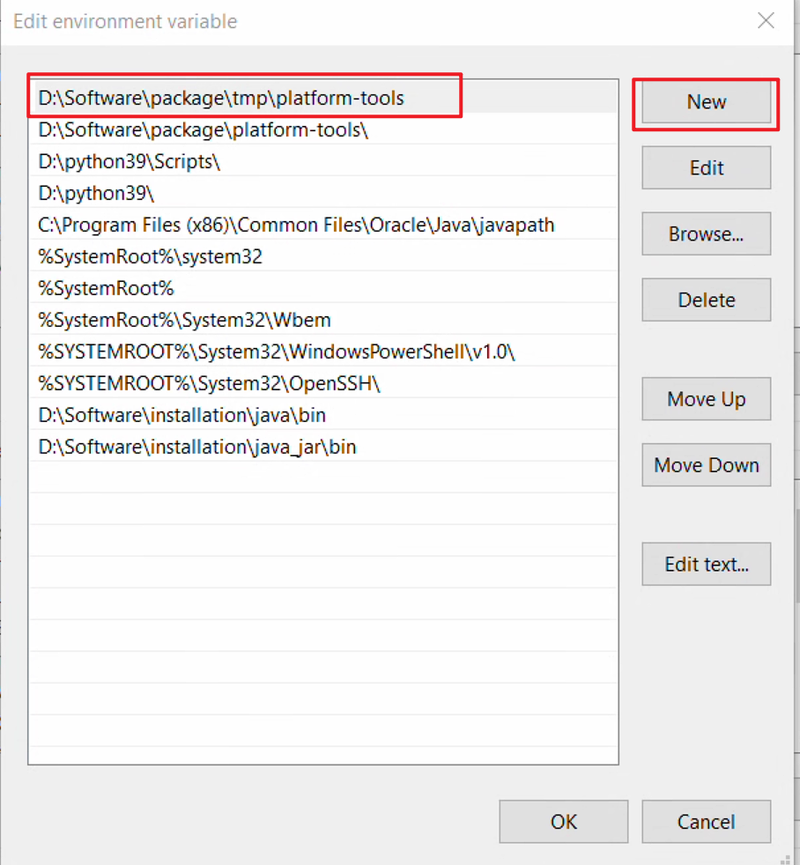

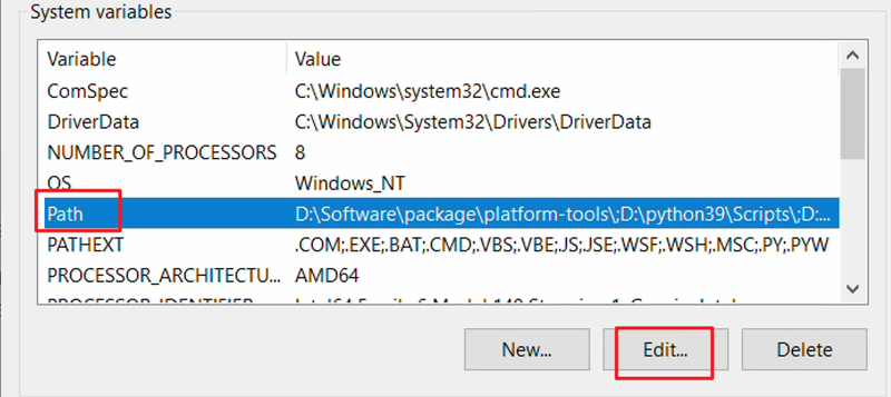

2.1.2.2 Configure ADB Environment Variables ​
  • Copy the path of the unzipped platform-tools folder.

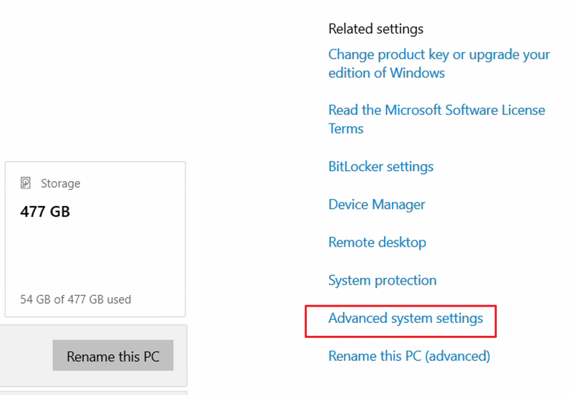

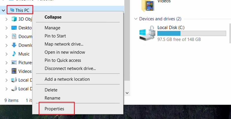

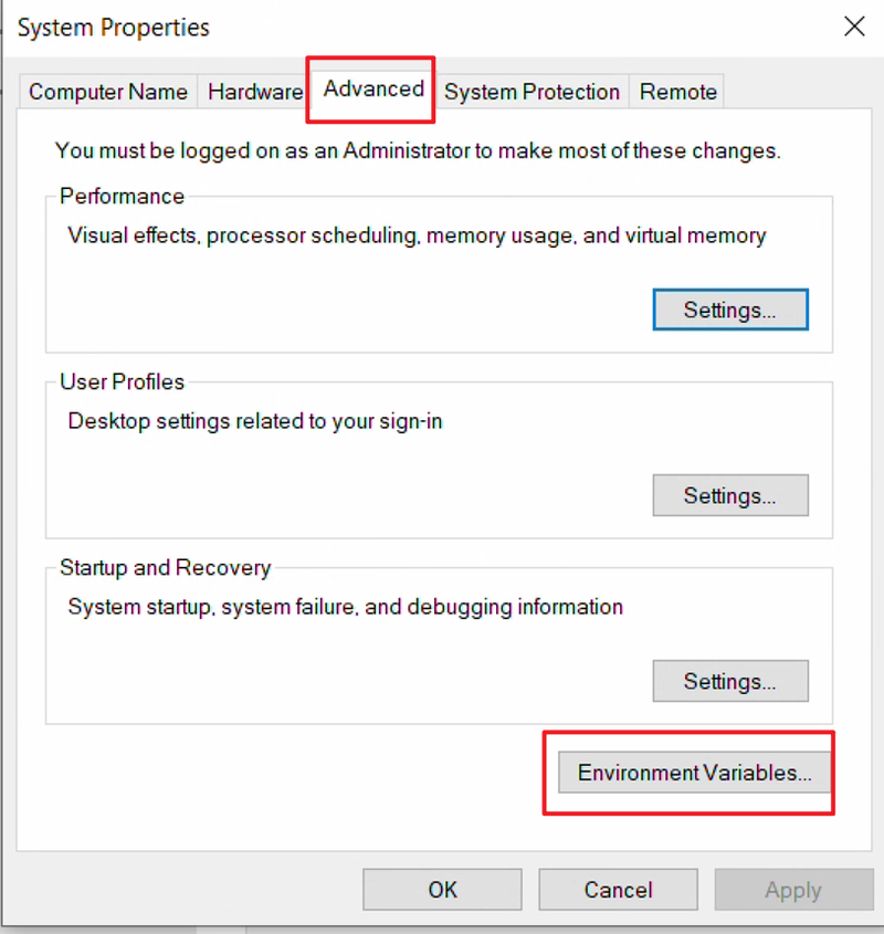

  • Right-click This PC and select Properties.
  • In the pop-up settings window, click Advanced system settings.
  • In the System Properties window (Advanced tab), click Environment Variables.
  • In the Environment Variables window, select the Path variable under System Variables and click Edit.
  • In the Edit Environment Variable window, click New and add the platform-tools path copied earlier.
  • Click OK sequentially to save the configured variables and exit.

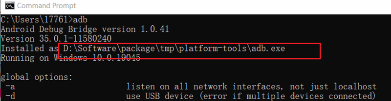

2.1.2.3 Verify ADB Environment Configuration ​

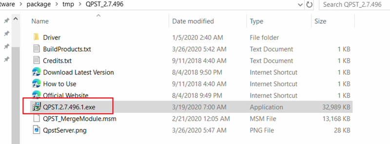

  • Unzip the QPST_2.7.496.zip file to the current folder.
  • Go to the unzipped QPST_2.7.496 directory and double-click the QPST.2.7.496.1.exe program to start installation.
  • Follow the prompts and keep clicking Next to complete the installation.
  • Default installation path after completion: C:\Program Files (x86)\Qualcomm\QPST\bin.
  • Enter this directory and send the QFIL.exe program to the desktop.

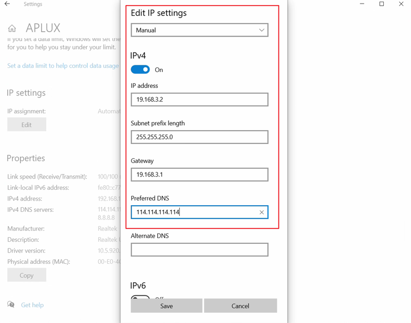

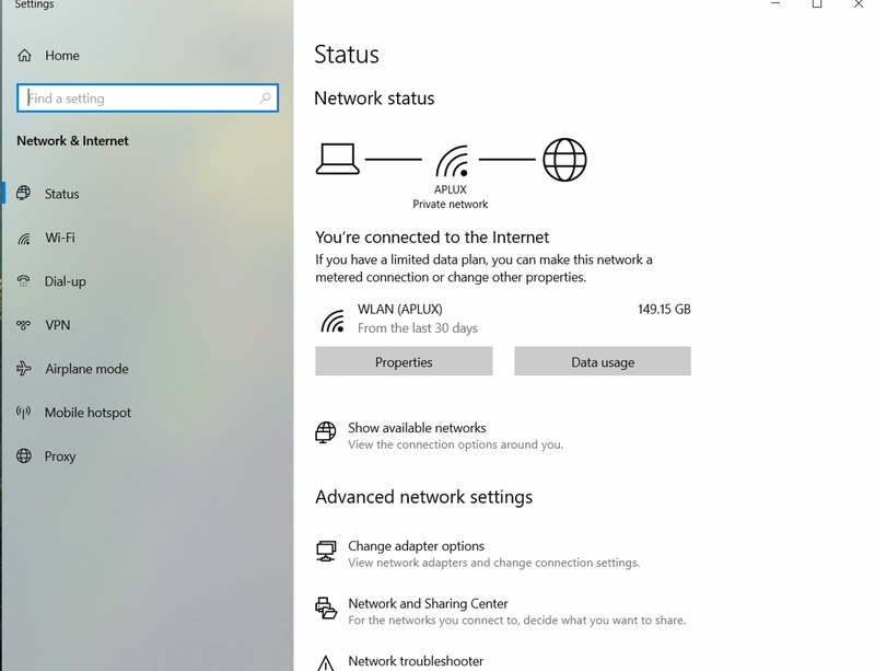

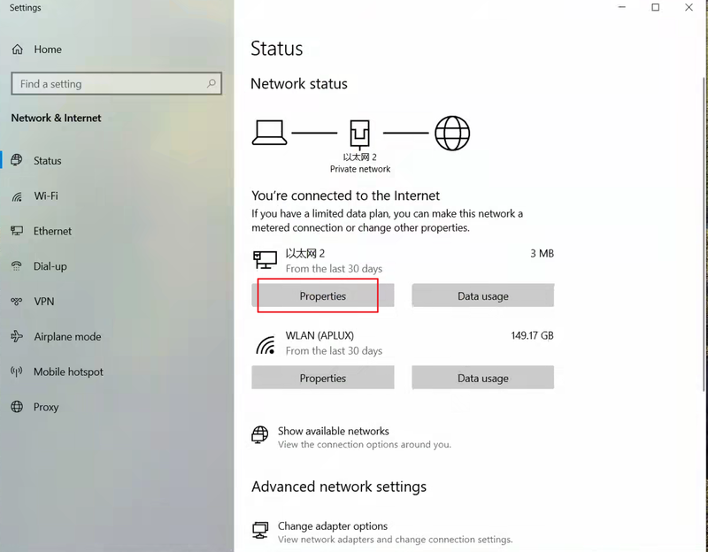

3.2.1 Configure Static IP for the Windows Computer ​
  • Press the Win+X key combination to open the system shortcut menu, select Network & Internet, and click Ethernet in the pop-up window.
  • In the Ethernet window, find the IP assignment section and click the Edit button to configure a static IP.
  • In the IP settings, select Manual, enable the IPv4 toggle, and edit the IPv4 address, subnet mask, etc., as needed.
💡Note
The IP address, subnet mask, gateway, and DNS information in the example image are for reference only. Configure them according to your actual network environment.
  • Click Save to apply the network configuration.

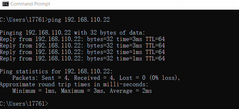

3.2.3 Verify Network Configuration ​
  • After configuring IP addresses for both the Windows computer and AIBox, test connectivity by pinging the AIBox from Windows. If the ping is successful, the configuration is valid. If not, check the network settings.

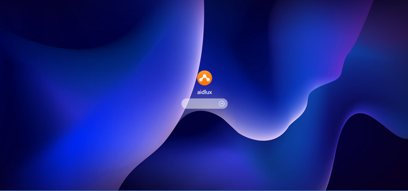

  • Enter the URL http://AIBox_IP:8000/login in a browser (replace AIBox_IP with the actual IP configured in the previous steps).Username/Password: aidlux/aidlux
  • After logging in, click the first icon labeled Terminal at the bottom to use the command line.

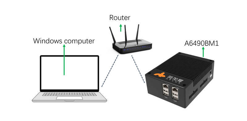

3.3 Wired LAN Connection ​
When the development environment has a local area network (LAN) with a DHCP server to assign IP addresses to connected devices, use the following steps to connect to and access the AidLux system:
Network Diagram:
💡Note
The device's Link0 port is a 2.5G Ethernet port, and Link1 is a 1G Ethernet port. Either port can be used.

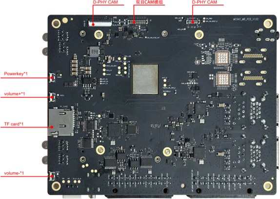

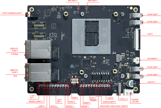

4. Hardware Interfaces ​
4.1 Description of Hardware External Interfaces ​
Hardware External Interface Diagram:
Functions of Hardware External Interfaces:
Interface NumberInterface NameFunction Description
1VOL-Volume Down Button
2UFS LightDisk Activity Indicator Light
3RAM LightMemory Activity Indicator Light
4TFTF Card Slot
5VOL+Volume Up Button
6PWR KeyPower Button
7PWR LightPower Indicator Light
8CAM LightCamera Indicator Light
9LINK02.5G Ethernet Port
10LINK11G Ethernet Port
11Type-Ax4 Type-A Interfaces
1224Pin-L24-Pin Interface (Left)
1324Pin-R24-Pin Interface (Right)
14Type-CType-C Interface
15WIFI/BT ANTWIFI/BT Antenna Interface
16DCDC Power Interface
Diagram of 24Pin-L Interface:
Functions of 24Pin-L Interfaces:
Pin NumberDefinitionAttributeDescription
L1OUT_3.3VOutput3.3V Output
L2GNDGNDGround
L3DBG_UART_TX_3V3OutputDebug UART Output
L4UART4_RXD_3V3InputUART Input
L5GPIO5/OUTI/O3.3V GPIO
L6I2S0_SCK_3V3Output3.3V I2S Clock
L7I2S0_WS_3V3Output3.3V I2S Chip Select
L8I2S0_DATA0_3V3I/O3.3V I2S Data 0
L9I2S0_DATA1_3V3I/O3.3V I2S Data 1
L10GNDGNDGround
L11RS232_1_TXOutputRS232 Output
L12GPIO40/OUT_GPIO_INTI/O3.3V GPIO with Interrupt
L13GPIO87/OUT_GPIO_INTI/O3.3V GPIO with Interrupt
L14RS232_1_RXInputRS232 Input
L15GNDGNDGround
L16SPI1_CS_N_3V3Output3.3V SPI Chip Select
L17SPI1_CLK_3V3Output3.3V SPI Clock
L18SPI1_MOSI_3V3Output3.3V SPI MOSI
L19SPI1_MISO_3V3Output3.3V SPI MISO
L20GPIO199/OUTOutput3.3V GPIO
L21UART4_TXD_3V3OutputUART Output
L22DBG_UART_RX_3V3InputDebug UART Input
L23GNDGNDGround
L245VOutput5V Output
Diagram of 24Pin-R Interface:
Functions of 24Pin-R Interfaces:
R1RS232_TXOutputRS232 Output
R2GPIO4/OUTI/O3.3V GPIO
R3GNDGNDGround
R4SPK_POutputSpeaker Positive Output
R5SPK_NOutputSpeaker Negative Output
R6GNDGNDGround
R7LINEOUT1+OutputOptocoupler Output 1 (Voltage set by PIN8)
R8LINEOUT1_POWERInputOptocoupler Output Voltage 1
R9LINEOUT2+OutputOptocoupler Output 2 (Voltage set by PIN17)
R10GNDGNDGround
R11CAN_H0OutputCAN0 High Output
R12CAN_H1OutputCAN1 High Output
R13CAN_L1OutputCAN1 Low Output
R14CAN_L0OutputCAN0 Low Output
R15GNDGNDGround
R16LINELN2+OutputOptocoupler Input 2
R17LINEOUT2_POWEROutputOptocoupler Output Voltage 2
R18LINELN1+OutputOptocoupler Input 1
R19GNDGNDGround
R20RS485_BOutputRS485 B Line

4.2 Description of Hardware Board Interfaces ​
Hardware Board Interface Diagram:
Hardware Board Interface Table:
InterfaceQuantity/Specification
C-PHY-Camera Modulex 1, IMX586(48M)
D-PHY-Camera Modulex 1, IMX577(12M)
Binocular Structured Light Camera Modulex 1, IMX577(12M)+2*OV9282(2M)
LCDx 1, MIPI interface, default ST7703, 720*1280 (customizable FPC adapter for higher resolution)
USB Type-Ax 4, USB3.0, host mode (total bandwidth: 5Gbps for 4 ports)
USB Type-Cx 1, USB3.0,supports DP1.4
LAN(RJ45)x 2, one port at 2.5Gbps, one port at 1Gbps
CANx 2
RS232x 2,for serial communication
RS485x 1,for serial communication
Optocoupler Inputx 2,5~30V
Optocoupler Outputx 2,5~30V
TF 卡x 1
I2Sx 1,3.3V
SPIx 1,3.3V
GPIOx 5,3.3V
UARTx 1,3.3V
Debug UARTx 1,for debugging
Headphone Jackx 1,3.5mm
SPKx 1,1.65W
Tri-color LEDx 4,tri-color indicator lights: red, green, blue
KEYx 3,power/vol+/vol-
Power Interface (12V/24V)x 1, external adapter power supply
RTCx 1,CR2032(225mAh)
ANTx 2,WIFI/BT 天线
Operating Temperature-30℃~+75°C
Storage Temperature-40°C ~ +90°C
Dimensions100 x 130 x 39.25mm

5.1 File Transfer via SCP ​
SCP transfer requires the A6490BM1 to be connected to the network. If the AIBox's IP address is 192.168.110.194, enter the following commands in the terminal:
Tip
Enter ifconfig in the AIBox's terminal to check the current IP address.
  • To upload the file test.txt to the /home/aidlux/ directory from a PC terminal, use:
  • To download a file from the AIBox to the PC's current directory, use:

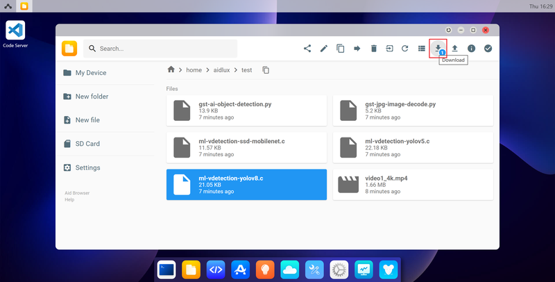

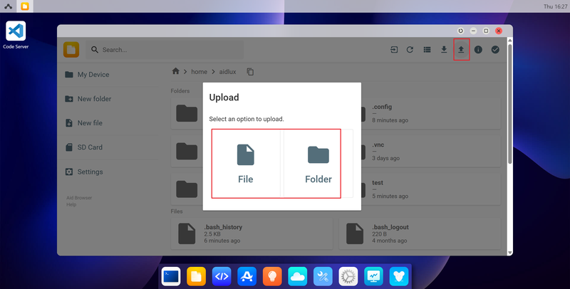

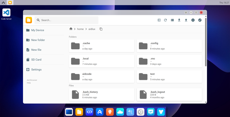

5.2 File Transfer via AidLux File Browser ​
File transfer via the AidLux file browser requires the A6490BM1 to be connected to the network. If the AIBox's IP address is 192.168.110.194, follow these steps:
Tip
  • Enter the URL http://192.168.110.194:8000/ in a browser to log into the AidLux desktop environment (password: aidlux). After logging in, click the file browser icon to proceed.
  • Click the Upload button in the upper right corner to transfer files or directories to the /home/aidlux/ directory.
  • Click the Download button in the upper right corner to download files or directories from the /home/aidlux/ directory to your local machine.

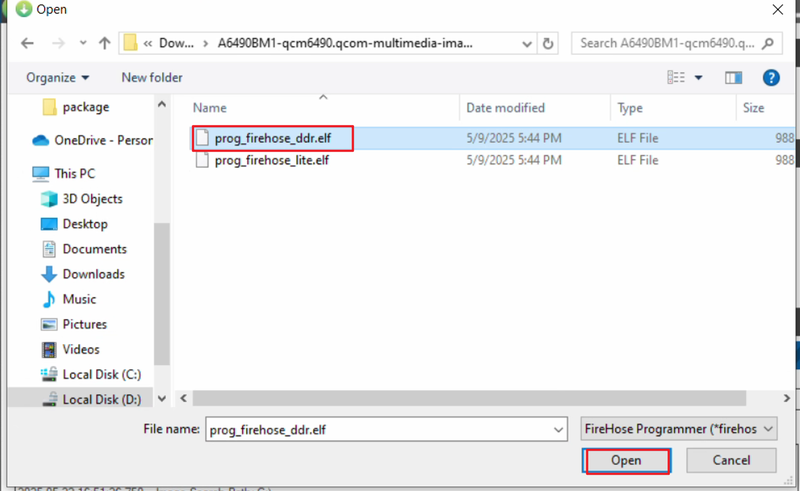

8.2.5 Select Flash Files ​
  • Unzip the ROM file.
  • Locate Select Programmer, click Browse... next to Programmer Path, navigate to the unzipped folder, and select the ROM file.
  • Double-click to select prog_firehose_ddr.elf.
