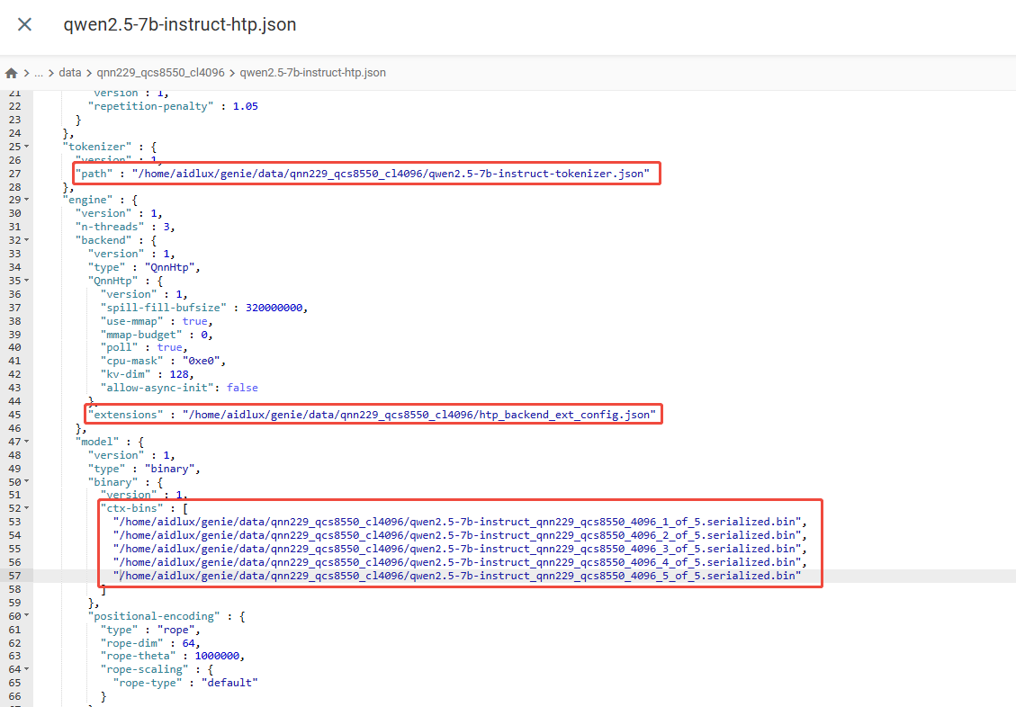

  • Configuration File Modification
Ensure that file paths in the configuration file are accessible, as shown in the diagram below:

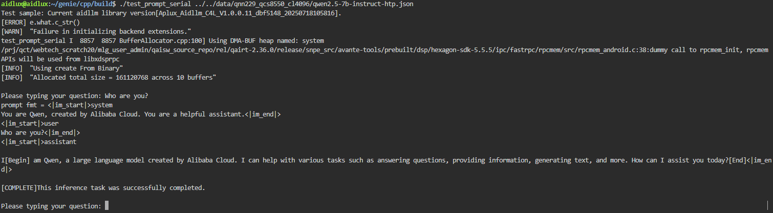

  • Compile and Run Example
mkdir build && cd build
cmake .. && make
# After successful compilation, run test_prompt_serial
./test_prompt_serial /home/aidlux/qnn229_qcs8550_cl4096/data/qwen2.5-0.5b-instruct-htp.json
  • Enter dialogue content in terminal
