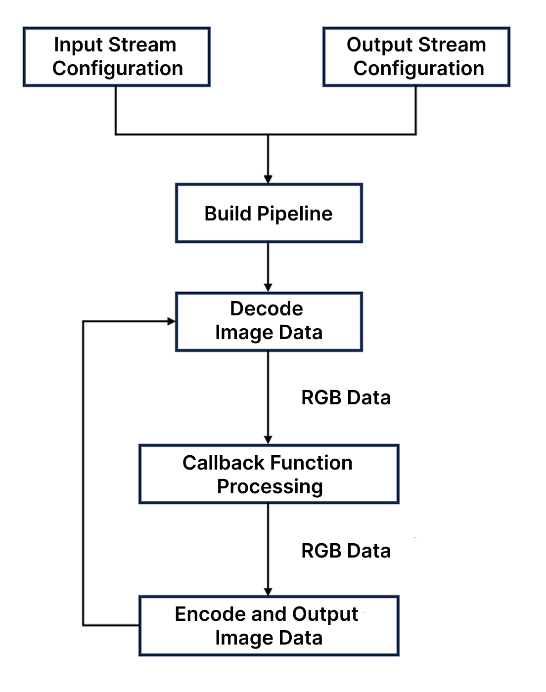

AidStream is based on the concept of a pipeline, where developers create the predefined streaming data processing pipelines that incorporate AI model inference and other complex tasks, such as video encoding/decoding, video stream pushing/pulling, and video stream storage.
In a complete pipeline, data enter from an Input-Stream, and developers can use AidStream API to obtain the corresponding RGB data. After processing, the data is then fed into the Output-Stream. For example, callback functions can be inserted between the input and output ends to retrieve RGB data. Pre-processing, AI analytics and post-processing are performed within these callback functions before returning the processed data back to the pipeline. The processed RGB data then continues through the subsequent stages of the pipeline's output process.
The AidStream workflow is illustrated below:
