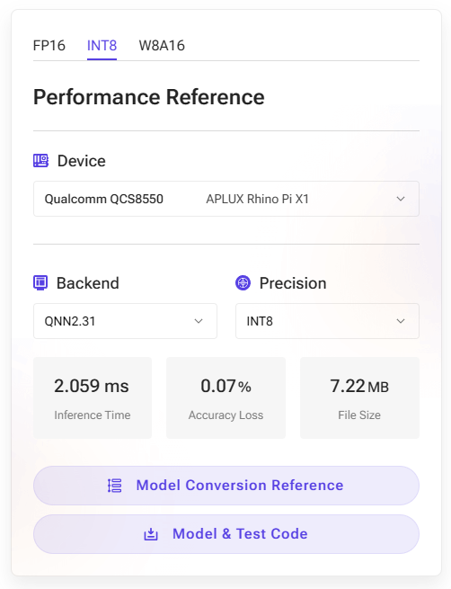

The model details page on Model Farm provides actual measured performance of AI models with different quantization precisions on corresponding hardware.
  • Device: The development board and corresponding chip model used for the actual performance measurement.
  • AI Framework: The framework and version number used for model conversion and inference.
  • Data Precision: The data precision used by the converted model.
  • Inference Latency: The actual measured time for model execution, excluding pre- and post-processing.
  • Accuracy Loss: The cosine similarity of the output matrix between the source model (FP32) and the converted model.
  • Model Size: The file size of the converted model.
💡Note
For the same SoC, model performance may vary across different hardware specifications; these figures should be used as a reference.
Example of YOLOv5s on Rhino Pi-X1 (Qualcomm QCS8550):
