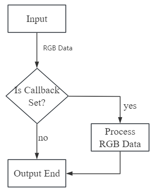

The only interface function that is strongly recommended for application code is:
cpp
int start_stream(string stream_id, GetImageCB &cb)
Use this function together with the configuration file /usr/local/share/aidstream-gst/conf/aidstream-gst.conf. Because stream configurations can vary significantly, starting streams through the configuration file is strongly recommended.
The installation package also provides example programs and a matching CMakeLists.txt under /usr/local/share/aidstream-gst/example/cxx/. See the sections below for details.
